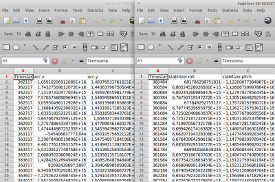

I noticed the size of single log block is limited to 28 bytes, which can only contain about 4-6 float variables.
Well, in my application, I have to log about 20 variables at the same time.
I tried to split them into 5-6 groups and build corresponding log blocks.
I used the interface to write them into files, but I realized they were not starting at the same time stamp because I have to click the check boxes for them one by one on the interface. Furthermore, all these log blocks are logging every 100ms, which means they can never log the data at same time stamp after.
For example, I want to log both accelerator and stabilizer data, but stabilizer starts at 360484 and acc starts at 362117.
How can I synchronize them? Or How can I start and write multiple log blocks into files at the same time?
Any suggestions will be helpful. Thank you!

What you are hitting is a fundamental limitation of the log subsystem current implementation, it has not been designed to acquire a large group of variables in a synchronized manner.
The log subsystem, if used from the lib, is capable of converting floats into 16bit floats. It helps a bit (if the extra precision is not needed), but not enough for your case.
Is your problem that they do not start around the same time or that the sample are not taken at the same 'instant'?
If it is the former, it would be fairly simple to write a script that crops the logs to make them start around the same time.
If it is the later, you could log quicker which means that the absolute 'jitter' between blocks will be reduced (ie. if you log every 20ms, there will be less than 20ms difference between measurements of different log blocks). Otherwise you will need to modify the firmware to either add custom logging code or make sure the logs are taken at the same instant.
One idea I have that might work, is to modify the log subsystem to batch log-block with the same period at the same time. For example all log blocks schedule at 100ms period could be scheduled on timestamp multiple of 100. I think it would work fine but it would require quite some refactoring to the log subsystem implementation in the Crazyflie. If you are interested in looking at that I would gladly help-out.
